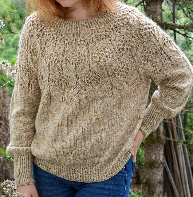

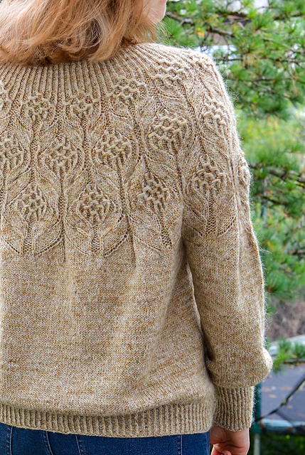

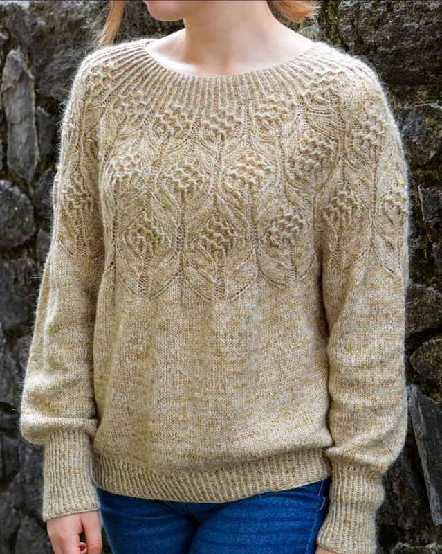

    TESSA is a cozy oversized seamless top-down sweater with a beautiful pattern on the circular yoke while the rest is made in simple stockinette. You can choose between two options for the yoke depth.
    The range of ease across all the sizes is 20-22.5 cm /8-9”. The picture shows size 3 with 21.5 cm/8.5” of positive ease.

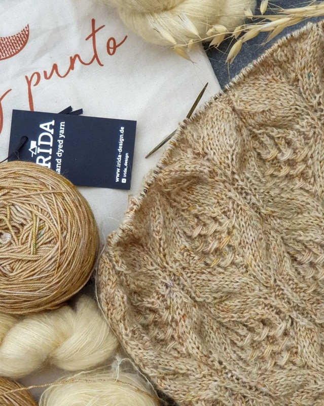

    YARN:
    LUXURY SOCK by FELIZ Y PUNTO, fingering weight, (70% Merino SW, 20% Silk, 10% Cashmere), 400 m/438 yds in 100 Gr
    Grams: 280 (305, 330, 355, 390) (415, 435, 465, 485, 515)
    Metres: 1120 (1220, 1320, 1420, 1560) (1660, 1740, 1860, 1940,
    2060)
    Yards: 1225 (1335, 1445, 1555, 1710) (1820, 1905, 2035, 2125,
    2255)
    I used colorway Sandstone
    HELD TOGETHER WITH:
    MOHAIR by IRIDA DESIGN, lace weight, (80% Mohair, 20% Polyamide), 225 m/246 yds in 25 Gr
    Grams: 100 (110, 120, 130, 145) (155, 160, 170, 180, 190)
    Metres: 900 (990, 1080, 1170, 1305) (1395, 1440, 1530, 1620, 1710)
    Yards: 985 (1080, 1180, 1280, 1425) (1525, 1575, 1675, 1770,
    1870)
