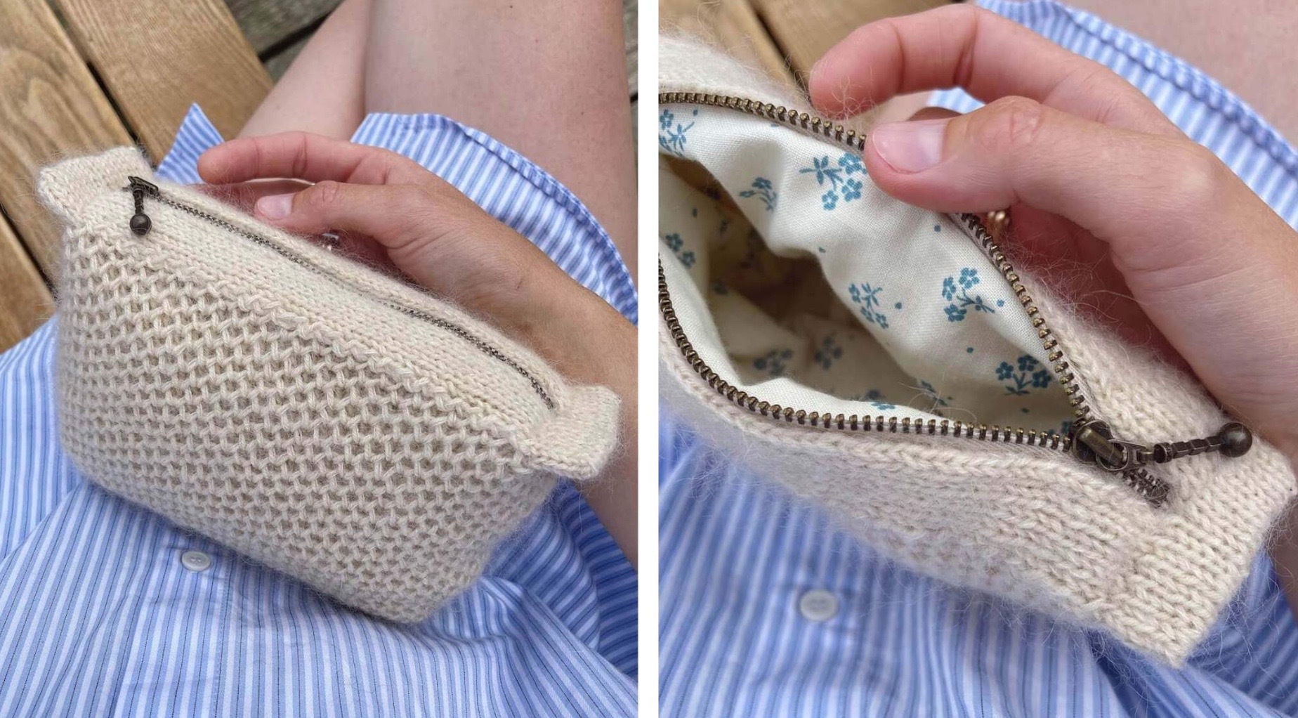

    Перевод описания на русский язык.
    The Honey Clutch is worked in one piece from the bottom up. First the bottom is worked in double knitting. Then stitches are picked up and knitted around the sides of the bottom and the sides of the clutch are worked in the round in honeycomb brioche stitch. For the top of the clutch the two tabs at the ends are worked first in double knitting, then the two plackets for the two sides of the zipper are worked. Finally, the zipper is sewn in with needle and thread and the lining for the clutch is sewn (either on a sewing machine or by hand) and installed. The pattern contains the sewing instructions for the lining.
    Length: 17 cm [7¾ inches]
    Depth: 6 cm [2¼ inches]
    Height: 11 cm [4¼ inches]
    Gauge: 24 sts x 32 rows = 10 x 10 cm [4 x 4 inches] in double knitting on 2.5 mm [US1½] needles 18 sts x 56 rows = 10 x 10 cm [4 x 4 inches] in honeycomb brioche stitch on 2.5 mm [US1½] needles
    Needles: Circular needle: 2.5 mm [US1½] / 80 cm [32 inches]
    Double-pointed needles: 2.5 mm [US1½]
    Materials: Approx. 30 g Sunday by Sandnes Garn (50 g = 235 m [254 yds]) or approx. 36 g Pelsuld 8/2 by Hjelholts Uldspinderi (100 g = 400 m [437 yds]) or approx. 24 g Saga by Filcolana (50 g = 300 m [328 yds]) held together with approx. 15 g Soft Silk Mohair by Knitting for Olive (25 g = 212 m [232 yds]) or approx. 15 g Tynn Silk Mohair by Sandnes Garn (25 g = 212 m [232 yds]) or approx. 16 g Silk Mohair by Isager (25 g = 210 m [232 yds]).
    4 mm, 17 cm 7¾ inches zipper.
    Fabric for lining, 25 x 36 cm [9¾ x 14¼ inches].
    Sewing thread and needle.
